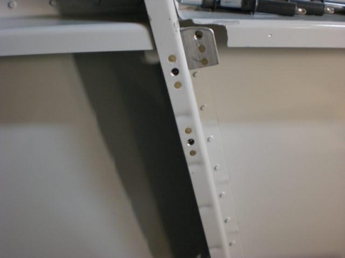

Spent the session finishing up on drilling several nutplates and riveting them. Next I moved to the nutplates that hold the rear of the side console panel to the F-805-L-1.

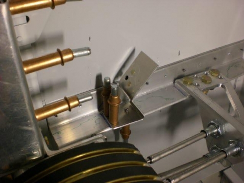

After the nutplate positions are drilled I open up the screw hole with a larger drill in order to give greater clearance to the screws for any mis-alignment. I positioned the bracket that holds the lower left portion of the canted panel and drilled the holes that will rivet the bracket to the F-864C angle.
After clecoing the bracket in place I match drilled the canted panel hole into the bracket. I then drilled and riveted a nutplate to the bracket.

Canted console attach bracket
Side panel attach nutplates
