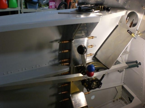

Brief Description:  Quad and Console #7
I began working on the forward portion of the left console. I re-installed the aluminum angle that spans the length of the console. I had to do additional fitting to the forward canted panel and tweaking the positioning.
After getting the fit on the panel I began to fabricate a bracket that would attach to the lower left corner of the canted panel. It will be riveted to the angle that holds the throttle cable bracket that is mounted to the side skin of the fuselage.
Canted Panel
Canted Panel
More fitting
More fitting
