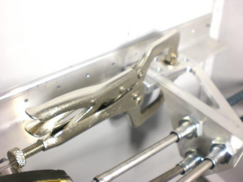

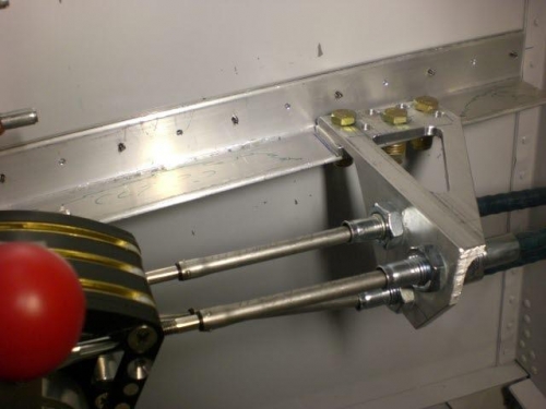

I had to further modify the wedge for the cable bracket doing some trimming to the length. Next I located the bracket and the angle in the position it needed to be and transferred the holes that I put in the bracket through the angle and the wedge.
I bolted it all together and checked out the quadrant lever operation, which ops checked good!
Modifying Angle
Modifying Angle
Wedge and angle drilled and bolted
Side view
Side view
