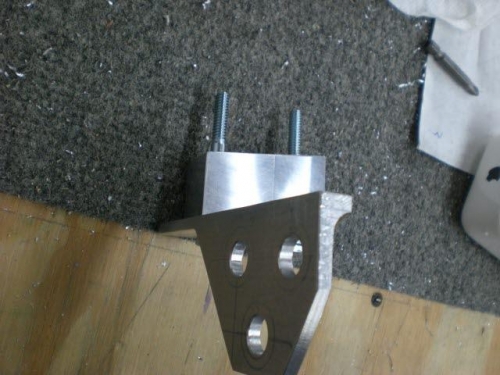

With the quadrant and cables installed I sat and played with the proper position for the bracket to attach to the fuselage sidewall bracket. A lot of time was trying this and that to try to get the location right.
After getting it in place and getting measurements I got a piece of aluminum and machined it to get the slight angle where it needed to be. Then I drilled the holes for the -4 bolts that will attach it. I still have to transfer the bolt holes to the angle where the bracket will attach.
Bracket and spacer
Bracket and spacer
