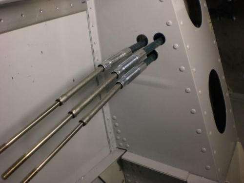

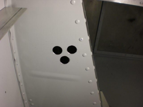

Brief Description:  Control Cable #2
I used a long #30 drill to make the pilot holes for the step drill. then I used the stepdrill to get the holes the right diameter for the snap bushings. I then got the engine control cables off the shelf and prepped the ends for routing by taking the nuts and washers off. Cables routed.
Holes drilled
Holes drilled
Cables routed
Cables routed
