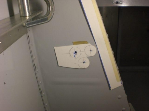

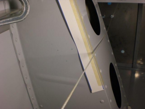

I measured and marked the hole locations for routing the engine control cables through the left gear tower. I attached a string to the throttle and the firewall cable holes. It gave me an elevation of wher on the tower I wanted to drill the carry through holes.
Next I made and cut out a hole location template and decided where it needed to be placed on the tower. After pondering for a bit I was satisfied with the location and taped it to the area and used the center holes to mark the locations of the holes.
Preparing to mark tower holes
Hole location template
