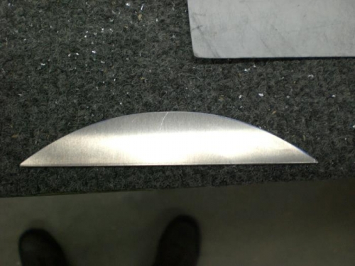

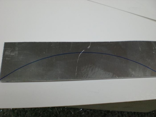

I began by fabricating a spacer for the side of the quadrant to make the surface even with the angle so when the side of the console is attached it will have a flat surface to be attached.
I simply used a piece of poster board and traced the quadrant profile to cut out a pattern then transferred it to the aluminum and cut and finished it.

Making quadrant spacer
Spacer fabricated
Spacer fabricated
