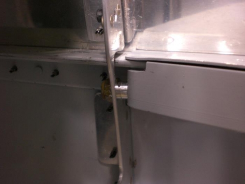

Brief Description:  Instrument Panel Spacer
The instrument panel frame attaches to the fuse via a -3 bolt and nut. After everything was match drilled and secured with clecos, there was a gap between F-816 Cockpit Rail and the panel. I decided to make a narrow spacer to place in the gap so I measured with feeler gages and made one. After making the spacer I bolted it all together.
Spacer Installed
Spacer Installed
