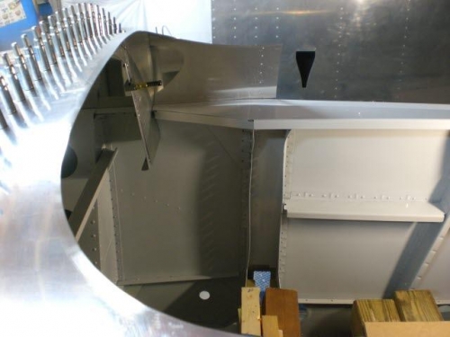

Brief Description:  Instrument Panel and Glareshield

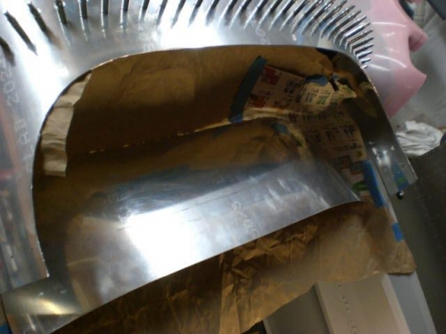

I made some marks for the center instrument panel to mate up against the subpanel covers. I decided it was time to cut the glaresheild to specifications. The kit I have has a little scribed line for where to cut the glareshield. Using my Dremmel cut off disc I was able to cut out the glareshield. Next I used the little drum sanding discs to smooth the cutout further. Finally using files sanding and scotch brite I finished the edges of the glareshield cutouts.
Glareshield Cut

Sanded with drum sander
Filed and finished
Filed and finished
