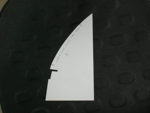

Brief Description:  Instrument panel (continued)
I did a little rework on the instrument panel. Next I decided to make the paper pattern that I can use to make panels for the for covering the instrument panel subpanels. I started with using normal printer paper and pressed it around the profile of the subpanels to get the form. I cut the paper with sizzors. Next I checked the paper pattern against the subpanels. When I felt it was close enough for a pattern and a close fit to the subpanels. I used the paper to make a stiffer pattern out of posterboard. The pattern is now ready for making an aluminum piece.
Next I decided to clean some clutter out of the fuselage.
Paper Pattern
Paper Pattern
