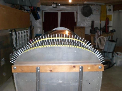

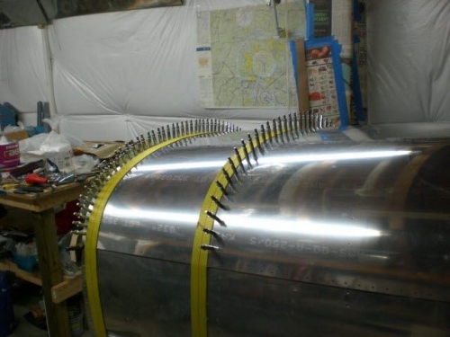

So after spending the bulk of the time positioning and re-positioning the skin and bulkheads to get it all lined up I began to match drill all the holes in the forward and rear bulkheads.
I was able to use some cargo straps and cleco clamps on the firewall and the setup worked well. The sides will be drilled in a couple steps from now.
Cargo Straps worked well
Bulkheads drilled
Bulkheads drilled
