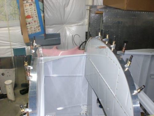

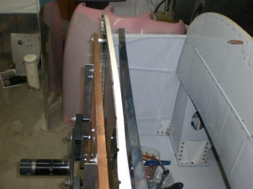

Spent the time getting the F-821 BPP Baggage Door Support Strips located and trimmed on the ends so they would fit correctly. There was a bit of fitting, trimming and refitting going on.
After I got that done I made a hole template for the front and rear strips using the cowling as a hole pattern to mark where the rivets would fall on the strips. The reason for doing so was to locate some "keeper" rivets to hold the strips down while I match drilled the holes in the cowling location the keeper rivets would not be interferring.
After doing all that cyphering I marked and drilled the locations of the keeper rivets.
Fitting Firewall Support Strip
Rear bulkhead strip fit
