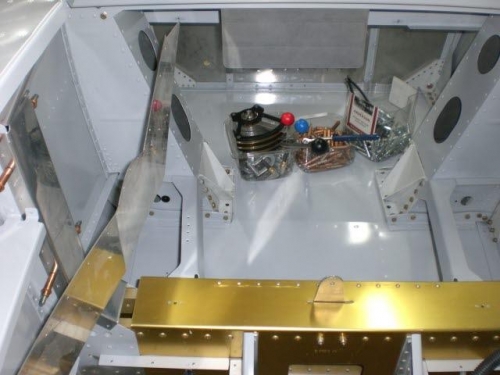

During the course of working the elevator tips I began the process of working and designing my interior consoles. After flying Twitter for four years I really became accustomed to and enjoyed Rick's design of the larger arm rest and throttle position that was in his RV8. Rob gave me Ricks old side panel template that Rick had given to him years ago....so it has been sitting in my stash and now is being used to plan my consoles. The work session involved cypherin....that is measuring and holding the throttle quadrunt up and just getting a plan of action in my head....that was the most of it....then back to sand the elevator tips. Still a productive day!
