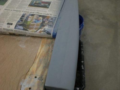

Date:  10-8-2018
Number of Hours:  2.80
Brief Description:  Sanding elevators
Spent the time mostly sanding. The tips looked pretty good to me so I shot primer on the right elevator tip. Well this is where the dreaded "pin holes" and other imperfections rear their ugly head. I saw pin holes, scratches, dips and other imperfections. I called to consult with Rob, Rick, and Jim to get some intell on the process. The bottom line is more micro and sanding. I am also ordering some poly filler that will fill the pinholes and give a smooth finish as well.
