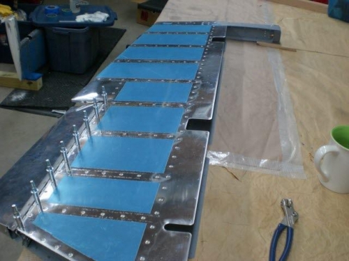

Mostly riveting tonight. I had to insert blind rivets into E-713, E-606PP, and E-701 Trim Tab Bends.

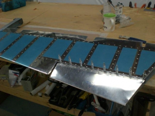

I put the Trim Tab on to check the elevator clearance between the bent tabs and the trim tab.
The gap is supposed to be a minimum of 3/32 (.093) and it is actually about 3/16 (.187) . So it is well past the minimum....I was thinking of redoing the hinge....but we will see. I would like the clearance to be closer to 1/8 (.125). I don't think I have any more of this hinge....will look and see.
Closer to being done
Elevator needs trim and rolled edges to be completed yet
