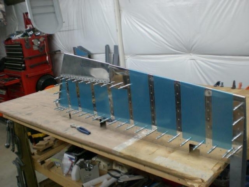

The elevator was ready for bending as the stiffeners have been riveted and primed. I noticed I really didn't feather the edge of E-713 counterbalance skin well enough where the E-701 elevator skin transitions over it. So I spent some time on feathering it better and then primed it.
After getting the elevator bent I clecoed it to the frame and everything looked good and lined up great. So now the process of riveting the multitude of rivets in the next session.
New skin on and all looks good
