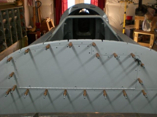

Now that all the interior and many parts are painted and ready I can start getting some of them installed. I installed panel F-866BPP which is the rear bulkhead of the forward baggage compartment on the RV8. In an earlier log I described making an access plate in that bulkhead because behind that bulkhead resides much of the avionics and electrical switches/components. I wanted to have the best access I could for maintenance purposes.
So to start I just used clecos to hold it temporarily in the airplane and checked the alignment and fit. After checking it and giving it a thumbs up I removed the panel from the airplane again.

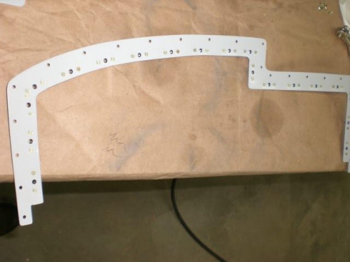

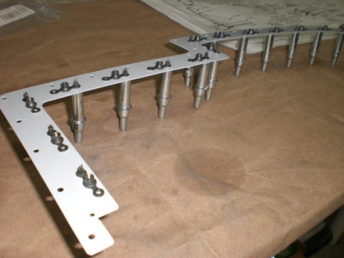

Next I got the 8-32 nutplates and clecoed them to the backplate for the door. Next I began to rivet them to the backplate. Now the backplate is ready to be riveted to the bulkhead.
Installed panel to check fit
Nutplates postioned
Nutplates postioned
Nutplates installed
Nutplates installed
