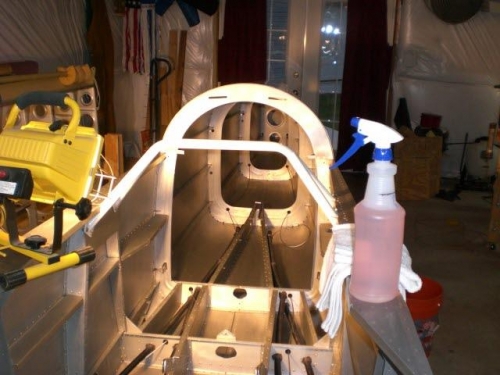

Brief Description:  Clean and prep fuse interior for painting #2
I completed the wet cloth cleaning of the fuse dust. That was stage one of the basically 4 stage cleaning. I am using Stewart Systems paint to do the interior. The color is a medium gray paint called Dawn Patrol Gray. It is just slightly darker than the color that comes on Vans powder coating. I decided rather than having the powder coating redone in a different color like some people do, I would keep it the factory color. Most of the frame is pretty invisable since it gets covered with fiberglass fairings. Also the color will be neutral and match about any color scheme that I end up using for the paint eventually.
So I mixed up a batch of Stewart Systems Eco Clean solution that is suggested by them to prep the surface. I was able to wash just the rear baggage area with the solution prior to finishing for the night. Tomorrow will continue with that process.
