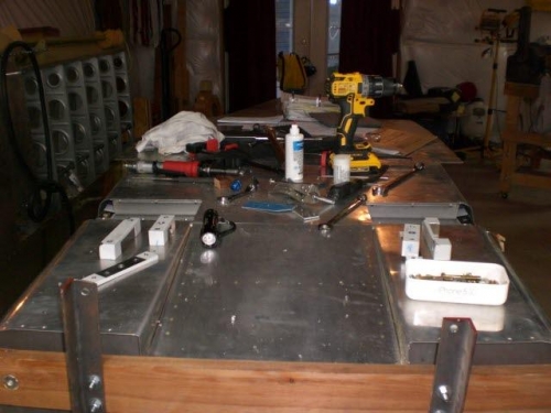

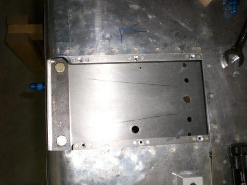

Brief Description:  Landing Gear - Drilling
I finished drilling the left gear to the fuselage. Performing certain operations on the QB kits can be a challange that slow build kits are able to avoid. I was able to drill the 1/4 inch inboard wear plates retainer bolt holes fairly easily. The outboard holes were a different story. I could not get the holes drilled with the gear in place so after drilling the inboard wear plate holes I decided to remove the gear and attack the problem in a different manner. That will happen in the next session. Anyway the gear was removed and the drilling almost complete as soon as I finish the outboard wear plate retention holes.
Right Gear Removed
Right Gear Removed
Left Gear Removed
Left Gear Removed
Gear Drilling almost complete
