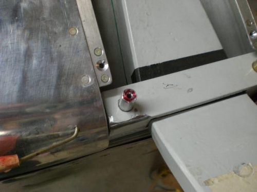

After getting everything lined up and prepped I for drilling the outboard 3/8 holes for the right gear bracket and wear plate. I decided to make up a pilt drill bushing to center the hole in the bracket and help assure that the 3/8 drill would have something to guide it in the proper location.

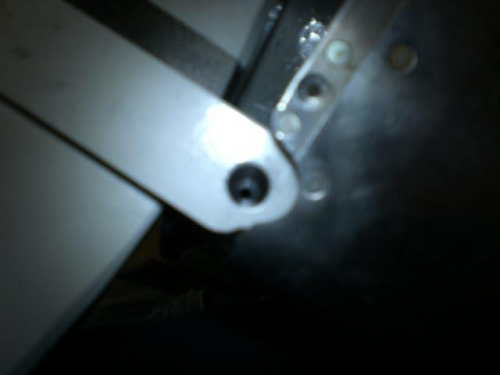

The pilot hole worked well and before you know it the holes were drilled.
Hole bushing for pilot drill
Pilot hole drilled
Pilot hole drilled

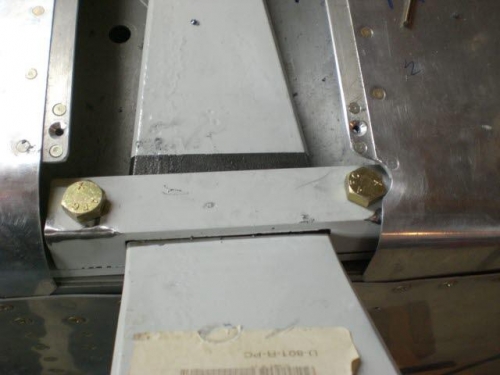

Right Gear outer bracket holes drilled
