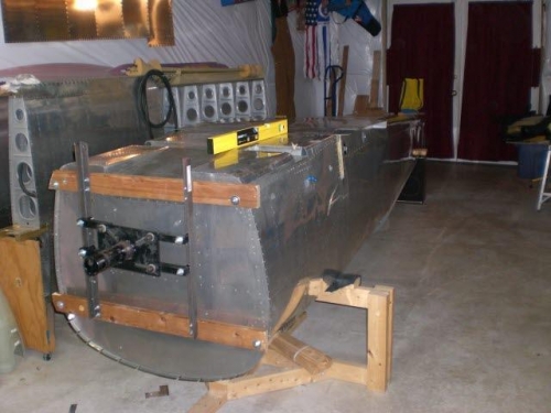

I was able to get the fuse flipped. Next I leveled the fuselage along both axis which took a little finessing.

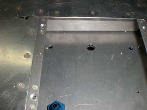

Next I transferred the 7/16 holes trough the floors by using the hole in WD-813 as a guide for drilling the location of the hole in the floor skins.
Fuse Flipped and leveled
Drilled 7/16" hole in floor
