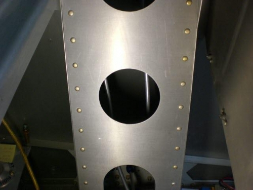

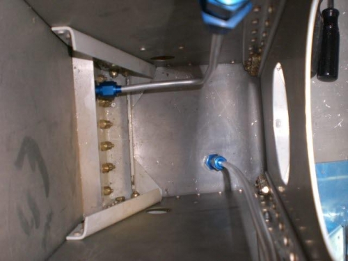

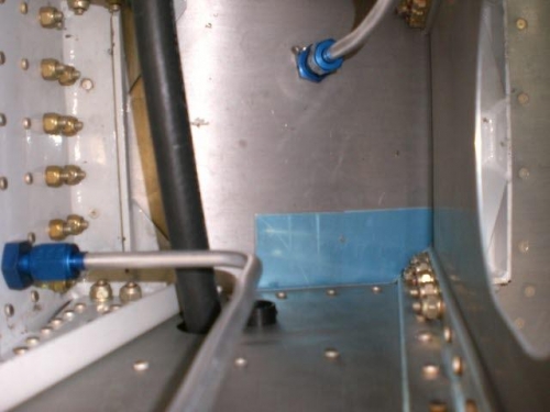

The second time you do something alway takes less time....well usually. In this case it did as well. I finished the lines in a reasonable time and wanted to drill the location for the brake line fitting.
