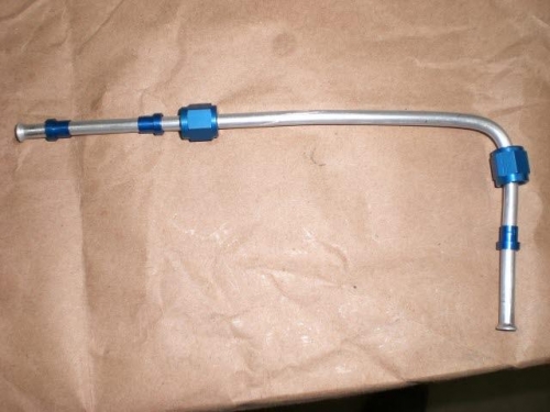

Brief Description:  Fuel Vent Lines Left Side

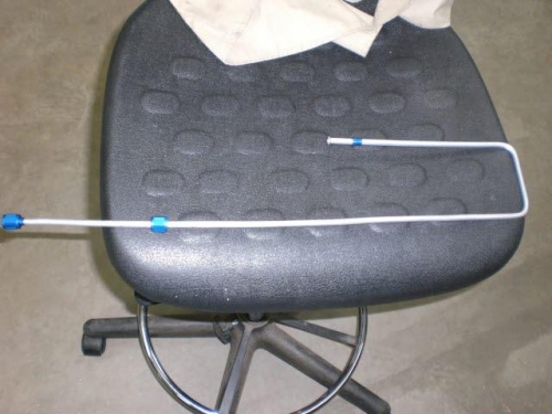

I completed the left side fuel lines in this session. In the plans it calls for a one piece solid line to be formed and inserted in the gear tower. I found that to be very difficult and decided to buy a couple couplings and make the vent lines into two pieces. What a difference that made. It was far easier to make and insert the lines into the cramped tower. Left vent lines completed, I began to fab the right vent lines.
Vent Line #1
Vent Line #1
Vent Line #2
Vent Line #2

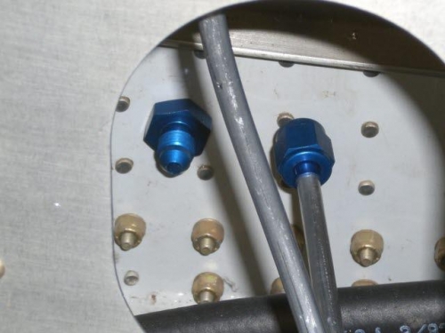

Sidewall fitting connection
