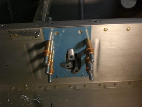

A drill guide is provided for marking the rivet holes for the support bracket which attaches to the rib on the left hand side of the fuse, and the tube guide located on the rib on the right hand side of the fuse. I located the drill guide in the proper locations and drilled the holes on the ribs.

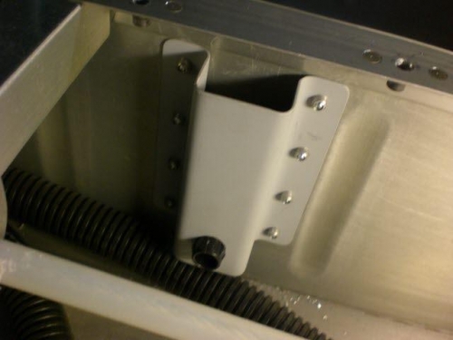

I riveted F-8110 and F-8119 together. Riveted F-8110 Tube guide to F-814R.
Drill template for tube guide
Tube guide
Tube guide
