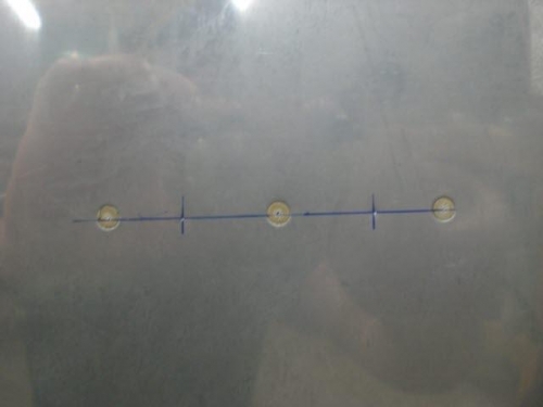

Brief Description:  Firewall & Manual Ail Trim
I located and marked the hole location in the forewall for the brake reservoir. Typically the reservoir is bolted into the firewall using platenuts attached to the angle behind the firewall panel. The problem in the QB kit is that there is no way to really get the nutplates on the firewall since it is already rivited to the angle. So I will drill the hole locations and use a bolt and nylon locking nut. Problem solved.

Marked the holes for Brake Res.
