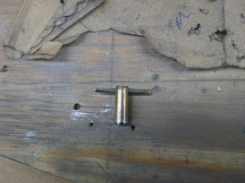

Fabricated the release latch and the locking pin for the adjustable rudder pedals. pretty straight forward. This is the second locking pin I have made though. I made the setup for my friend Rick when we installed the adjustable pedals in his airplane. He had installed the ground adjustable pedals in his airplane when he built it.
Anyway the roll pin that gets inserted into the locking pin is a real pain. I drilled the hole the right diameter but the pin still has a pretty good press to itl I decided to get a 1/4 inch piece of rod and drilled a 3/32 hole in the end to use in order to drive the pin into the locking pin. That seemed to work best to get the pin driven into the locking pin. Either way it is a pain!
Release Latch
Release Latch
Locking Pin
Locking Pin
