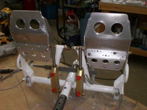

Brief Description:  Rudder Pedals - Master Cyls-release latch

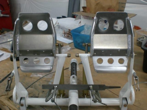

I reassembled the rudder pedals along with the extensions to the WD-804 L & R rudder pedal weldments. Next I I attached the master cylinders to each pedal. I attached the left cylinder to the rudder pedal as well. I used a file to clamp the the left and right pedal weldments together to check for pedal alignment. The marked hole location in the right pedal was checked with a 3/16 ths drill and proved to be almost exact. The hole was drilled in the right rudder pedal.

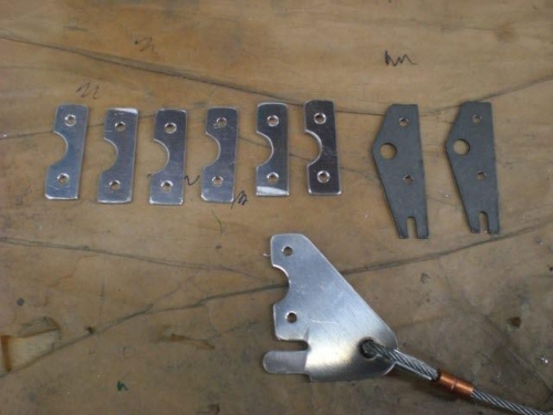

Deburred and attached the right rudder pedal master cylinder. I then seperated a the parts for the rudder slide adjustment latch. I began (once again) the process of finishing the edges and final drilling the holes for the rivets.
Pedals with master cyls
Checking pedal alignment
Parts for adjustment release latch
