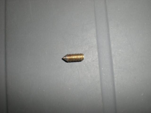

I decided to mark the location by making a transfer screw. I put an 8-32 screw into my Dewalt drill and started it spinning and used the belt sander to remove the head and then produce a point in order to insert it in the current hole and transfer that location to the inboard angle. After inserting the screw into the location I made sure it was just high enough to transfer into the inboard angle.

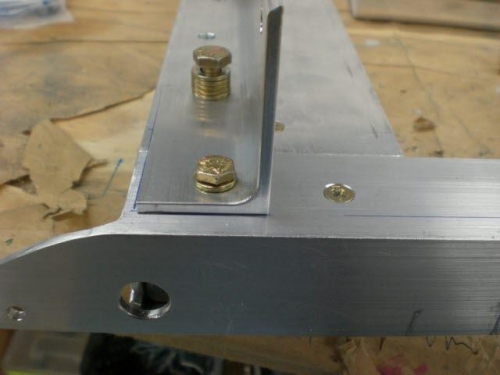

Next I aligned the angle into the correct location with the bolts. I placed a scrap piece of aluminum on the inboard angle and gave it a tap with a hammer. Voila.....it transferred beautifully.
Next I removed the rear block from the tubing and located the hole precisely and drilled and tapped it for a 10-32 heli-coil. All matched up for another successful operation.
Made a transfer screw

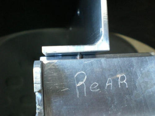

Screw in location ready to xfer
Successful outcome!
Successful outcome!
