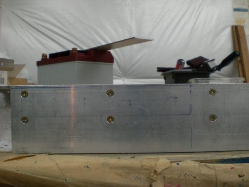

Tonight I only had a short work session. I deburred all the holes on the backing plate then fitted it. I ground just a hair off the left side of the backing plate (see photo 2) for just a bit more clearance from the tube. Next I attached the backing plate to the tube in order to perform the next stage of locating and drilling the inboard attach angle to the tube and backing plate.

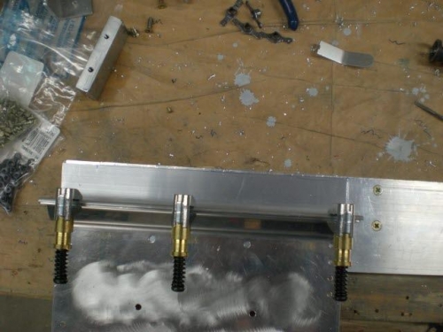

Backing plate attached

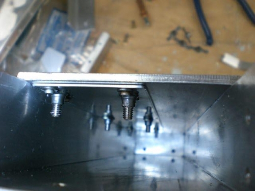

Inside view of backing plate
Inboard attach angle drill prep
