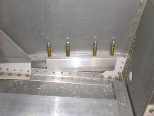

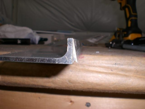

So using two inch angle I machined one side down to fit under the right bottom longeron. I knew that the longeron would not be perpendicular to the battery tray and considered my options. I felt that the best way to resolve the problem was to make a small angle that woud shift the side mount to make it perpendicular to the tray.

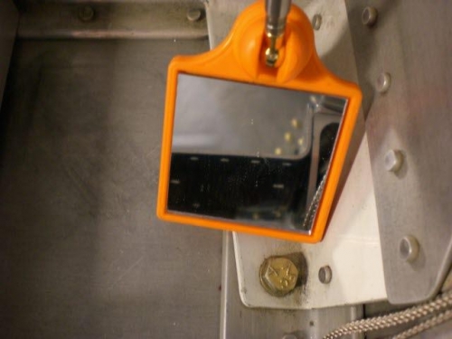

During my pondering it dawned on me that I had some pieces of Vans practice kit in my scrap box. I dug through it and came out with the training edge angle that I knew was in there. I knew it was a long shot that the angle would be the correct one that would work....but I figured it was worth a try. Well to my total amazement when I cut and installed the wedge it was ABSOLUTELY PERFECT! You can see in photo 2 on the far right side of the mirror is the battery tray and the angle perfectly matched and perpendicular! It is great when things just haphazardly work out!

Side mount with trailing edge wedge
Perfect perpendicularity
Drilled and ready for nutplates
