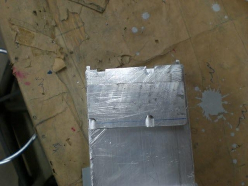

Brief Description:  Battery mount (cont)
As I am stepping through the process I have to make small modifications to the parts. Here I have made a few relief cuts in the forward mounting block in order to give clearance to existing rivets
in forward firewall angles that the battery mount tube will rest upon and bolt to. So I removed the block after marking where to put the relief cuts and modified the block.
