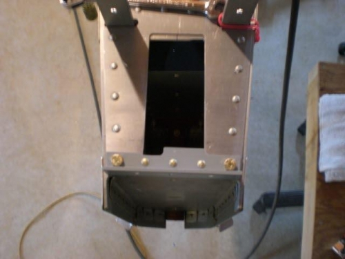

Number of Hours:  0.80
Brief Description:  Install F-812
Short work session tonight. After priming and painting the F-812 elevator stop I took time tonight to install it. It only involved two bolts and three rivets. Installed the bolts and match drilled the rivet holes from the stop into the airframe. Removed F-812 and deburred all holes. Reinstalled bolts and torqued. Then put in the rivets and was able to use the rivet squeezer which made it simple to get the rivets set.
F-812 Bolted and riveted
