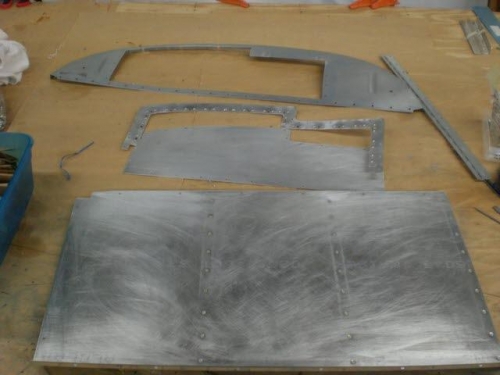

I have been wanting to tackle the instrument panel access panel on the rear panel of the front door baggage compartment. I made this in order to gain additional access to the future avionics that will be installed when the time comes. I need to prime and paint the pieces, so I started with finishing a little deburring of holes then scuffing in prep for priming. The photo shows the foward baggage floor scuffed and ready also.
Then I sat for a while and figured out which rivets I needed to assemble the door pieces as well as attach the panel back to the fuselage. It appears I have all the right size rivets to do the job albiet having to change the bottom half of the hinge by opening up the holes to accept AN470AD-4-4 rivets. I was planning to use AN470AD-3-4 rivets but found none in the kit hardware and don't want to order 30 cents of rivets and pay several dollars to ship them...so I will just open the holes up for the larger rivets.

Instrument Acces Door
