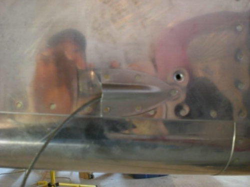

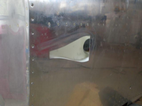

The NACA vent went on well also. I put the vent on and used a marker to mark the position. When I was happy with that I spread the proseal on the vent itself and set it in position. I pressed it down to set it. Then I took the extra proseal and spread some around and put a fillet around
all the edges to add leak protection from water.
