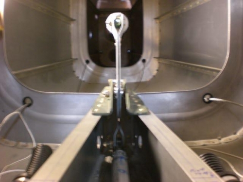

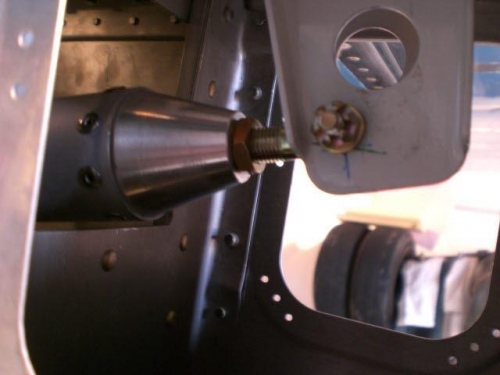

I began installing the control system in order to ultimately adjustt the elevator deflection to the
25-30 degrees deflection called for in the prints. Nothing difficult here....simply bolting all the
items together. I have been using castelated nuts so I wouldn't use the nylon lock nuts at
this point since all this comes back out after I adjust the elevator and rudder limits.
