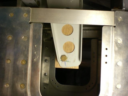

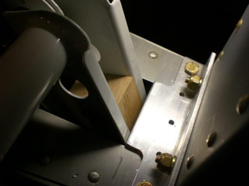

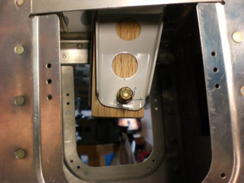

After drilling the hole in the Left Elev Horn I made a block out of hardwood the thickness of the
gap between the left & right horns. I used my dial calipers to and determined I needed a block about .940 thick.
My friend Jim calls me a cheater and maybe I am.....but I took the block out to my mill machine
in my shop and machined it down to size....exactly .940. The block slid inbetween the horns
very nicely. I located it to where I felt there would be plenty of meat around the hole in the wood.
I marked the location of the hole in the Left Horn. Next I drilled a #12 hole through the block in the location I marked from the hole in the Left Horn.
I set the block in the horns, then clamped them with the wood inbetween very tight while using the
#12 drill to locate the hole in the block in exact alignment. Then taking the drill and being certain I
held it nice and perpendicular so it would l"leverage" the block out of position I carefully transferred the #12 hole through the Right Elev Horn. All worked well and MED's were ample. Pics below show how it came out in the end product.
Left Horn

Right Horn
Right Horn
Top View
Top View
