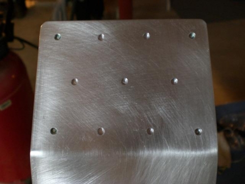

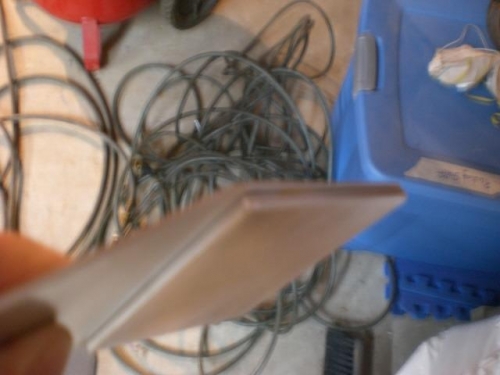

Measured and drilled the holes into the F-681 Vertical Stab Attachment Bracket. Next I placed the F-884 Spacer on the attachment bracket. I used double-sided sticky tape to hold the spacer in place so I could get it placed exactly where I wanted it.
There have been a number of places that I have been able to use the tape to hold things in place when hands are limited. The double-sided tape is only about .005 thick and there is nothing that
will be affected by the tape. It turns a frustrating job of trying to keep everything in it's place into a
simple event.
I positioned and adjusted the F-681 on theVS-702 VS Front Spar. After I was happy all was as
it was supposed to be, I began the process of transferring the holes from F-681 into F-884 &
VS-702.
F-681
F-681
F-884 Spacer
F-884 Spacer
