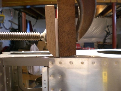

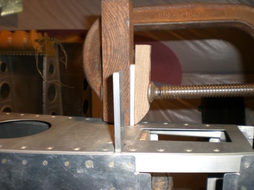

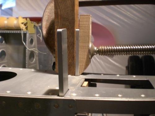

Brief Description:  Correcting position of F-811 HS Attach ba r(cont)
Using a large C-clamp and a few taps with a soft-blo hammer did the trick. The attach bar was nice and parallel. when I got the HS positioned properly, it required that I put in approx .060 of shims in order to get the HS set perfectly. Time to set up the HS to drill it in place!
Gingerly repositioning the F-811
