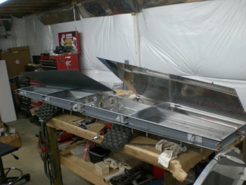

Today I removed the skins from HS skeleton. I final drilled the new HS 801 skin without it being on the skeleton because I am using the previous ribs that were already drilled and dimpled. The new HS0005 & 0006 ribs along with the HS702 L&R Spars were also match drilled since they are new.

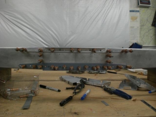

Match drilled holes from HS810/814 through HS0003 reinforcements.
