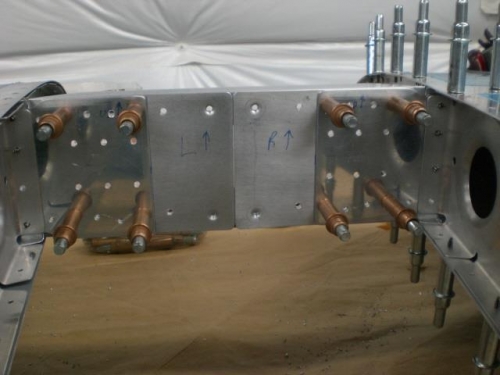

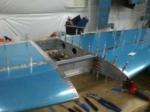

Removed clamps and clecos from left ribs. Installed HS-0005/0006 on right ribs for the right side of HS. After getting everything positioned just right....I match drilled all the holes for the ribs and HS-702 Spar.
All in all the process has gone well. I am glad I bought the new parts and just did a rebuild of the necessary parts. This gives me greater confidence of the rebuild rather than simply putting in the fix as per the SB. It is far less work doing this now than after the aircraft is flying , assembled, and painted......well worth the effort and small expense at this time!
Right side ribs complete(HS inverted)
Left and Right ribs on HS completed
