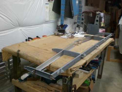

Brief Description:  HS Rebuild cont
So this is a lot of deja vu. I have already build the HS and took it apart to do a modification. I am glad I did as the modification makes the HS really beefy in the attachment area of the front spar. I ended up buying more parts to replace some that have been compromised during dis-assembly.
So during this session I began with drilling the 2 holes in each of the L/R HS-0006 ribs. I then put the skeleton together in preparation of continuing the process of the rebuild.
HS skeleton assembled
