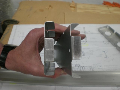

I dimpled the four rivet holes on the HS-702 Spar. Next I had to make some cuts on the HS-0006 nose ribs. Instructions called for cutting a segment of the rear attachment of the rib to give clearance to the HS-814 reinforcement angle. I was able to mark the part and using a dremmel tool cut and form the notch without too much trouble.
In reality, I had a little bit of trouble figuring out what they wanted to remove from the rib. I put my magnifying goggles on and then I saw it. The print I recieved from Vans for some reason was printed on the "light" side. I couldn't dee the hatch marks that depict removing the material. I also notice it difficult to read some dimesion lines. Anyway got it figured out.

Notches removed
Notches removed

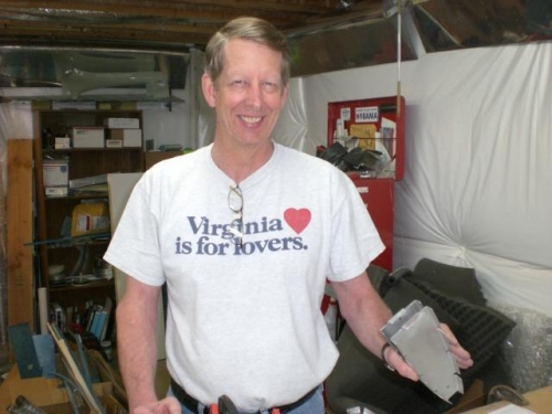

Captain Steve holding the evidence
