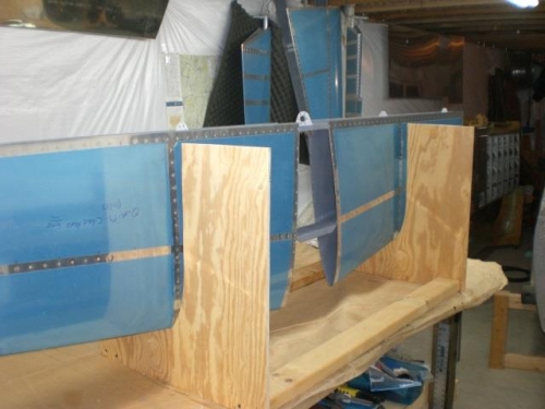

Brief Description:  Build HS Cradle

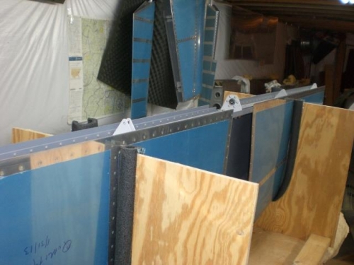

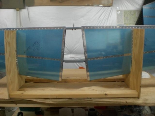

In the process of getting out the skin rivets and rib flange rivets, I found out that laying the HS flat on the table is not the best position for working on the HS. I decided to take time and some plywood and 2x4s I had laying around and make a cradle to work on the HS. This job is one that is such an extra pair of hands would be helpful....and since I don't intend to mutate i decided to build the cradle instead which is just about as good. I used a 1/8 aluminum welding filll rod that I have a box of to get the contour of the HS where the mid rib is located in order to have more structural support.
After bending the rod around the leading edge I taped the open rod ends to the proper rear spar dimention. I then traced the rod contour on the plywood and cut out with a jigsaw. I cut the contours oversize because I intended to buy some foam pipe insulation to set in the cutouts in order to get a snug fit and protect the HS from damage. Easy peezy. The cradel has worked tremendously!!!!!! It was worth the time of fabricating.
Cradle
Cradle
Cradle
Cradle
Cradle with Pipe Insulation Foam
