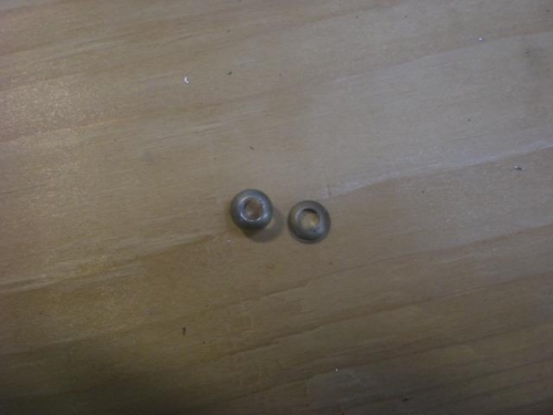

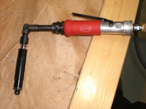

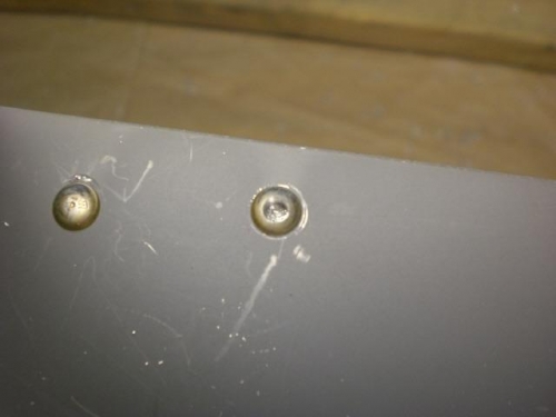

Removed the flange rivets on the ribs (see previous post). Probably the best tool to use for removing rivets is the Rivet Removal tool I bought for under $50. The tool centers the drill bit on the rivet head so it drill down the center. As I found out in later work sessions...it works FANTASTIC as long as there is enough clearance to get the tool in perpendicular to the rivet. Removing some rivets on the HS-810 Reinforcement Angle had very restrictive distance from the angle to the rivet location. Will detail that later.
Angle Drill and Rivet Removal Tool
Drilled with Rivet Rem Tool
Heads pop off...nice
