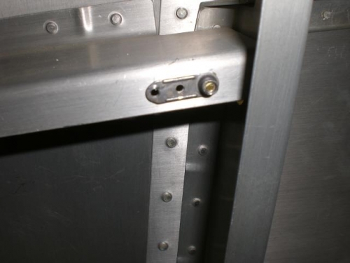

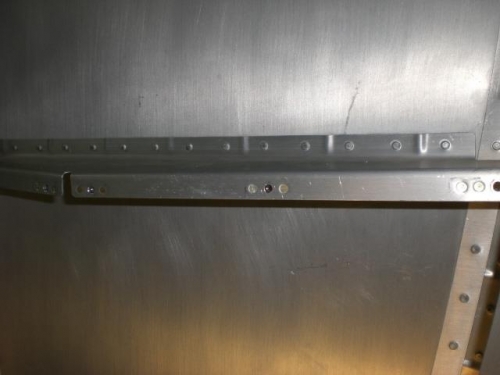

I marked the left and right cover top edges with the locations of the attach screws as depicted in the plans. After attaching the rear covers in their locations I made sure that all looked good and then drilled the screw attach holes in the upper edge that attach to the armrest.
Next was drilling and installing the nutplates. I had to use a one lug nutplate at the end. I do not have a drill jig tool for one lug nutplates. So I used my little screw/tube setup and attached the nutplate to the outside and match drilled the holes using the nutplate itself. Worked great. I was able to use a stubby screwdriver to attatch the nutplate.
The installation of the left and right rear covers are complete!
Nutplates installed in armrest
Using one lug nutplate for drilling jig
Rear side cover totally installed
