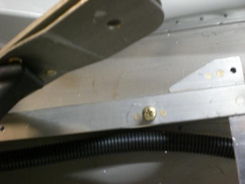

Brief Description:  F-837-1 Nutplates
I had to drill out the rivets for #8 screws that had been installed for the floor. The new F837-1 bracket uses the forward holes that are used for the floor fastening, but I had to change the nutplates to #10. I had to remove all the floors to change the nutplates so it was disassemble mode again. Removed the floors and change the nutplates.
Nutplate ready for installation
