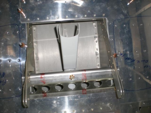

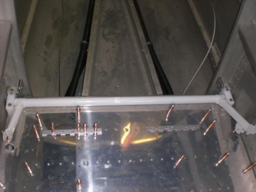

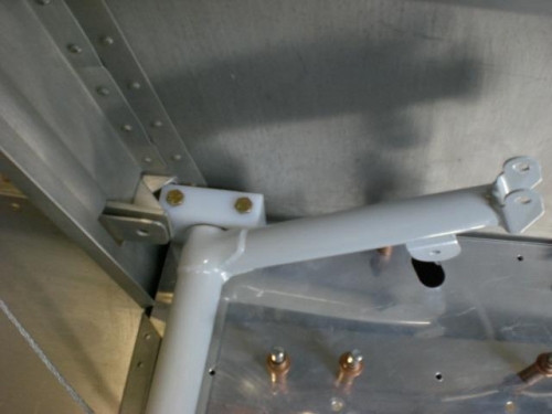

Installed the floors back into the interior. Trimmed flap blocks as per print instructions. Positioned flap weldment and blocks into position. Drilled holes for flap blocks. Installed F837-1 control arm bracket to match drill rear holes.
My kit came with the parts to manufacture the F837 bracked. To manufacture the F837 bracket it used two short pieces of 3/4 square alum tubing and a piece of alum angle that had to be cut and contoured. I saw the F837-1 bracket in someone elses build log and called Vans to get pricing. It was very reasonable so I ordered one. I felt it was a lot better setup than the old F837 bracket.
F-837-1 Control Arm Bracket
Flap Blocks Install
Flap Blocks Install
Flap weldment and blocks
