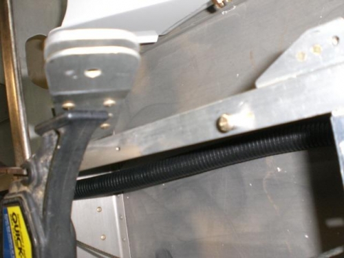

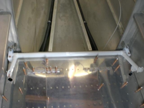

Located and drilled holes through bulkheads for 4 wire conduits. I sat down for a while to try and figure how many I would need and it appears that 4 would be enough. Deburred holes and began to wrestle the adel clamps in place to hold the conduits. Adel clamps are somewhat of a pain to work with.....but all and all it wasn't too bad.
Under floor conduits
Baggage area conduits
