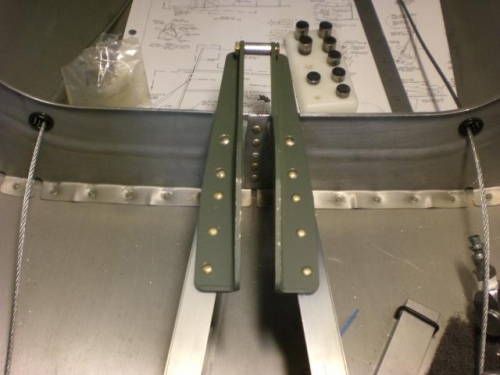

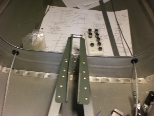

Brief Description:  Garmin Elevator Bellcrank Brackets
Performed the final installation of the Garmin Bellcrank Brackets. The installation required AD470-5 rivets. I found some in the empennage hardware. I could use my pneumatic squeezer for the three forward rivets but had to buck the two rear rivets. All in all it was not too bad. Just crunching my 6'2" frame into the tail section and getting the bucking bar under the rear two rivets required some patience.
Next job will be running some conduit through the baggage area for the future electrical wiring.
Bracket in position for installation
Bracket installed
