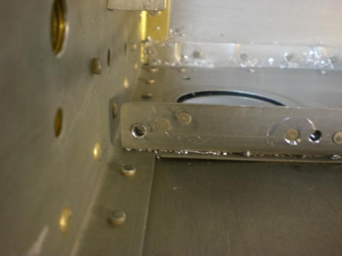

I had to purchase some one lug nutplates for the corners of the floor. These are not the typical nutplates but the angles that form the floor support were cut a little too short not allowing the regular K1000 nut plate to be installed.
Drilled, counter sink and riveted in the one lug nutplates. You can see that the angle is a good quarter inch short of the spar center section.
One lug nutplate installed
